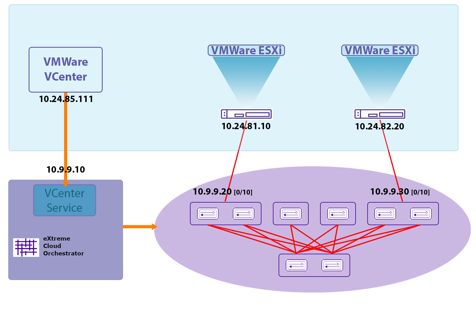

Example Network
The following network diagram will be used throughout this section to explain the various configurations.
Sample Network Diagram
This table lists the devices, their IP or Port information, and their role within the example network.
IP Address & Port Device & Role
10.24.85.111 VMWare vCenter Server
10.24.81.10 ESXi Server #1
10.24.82.20 ESXi Server #2
10.9.9.10 XCO Server
10.9.9.20 [0/10] Fabric Leaf Node #1. This node is connected to the ESXi server with IP address 10.24.81.10 on port 10.
10.9.9.30 [0/10] Fabric Leaf Node #2. This node is connected to the ESXi server with IP address 10.24.82.20 on port 10.
